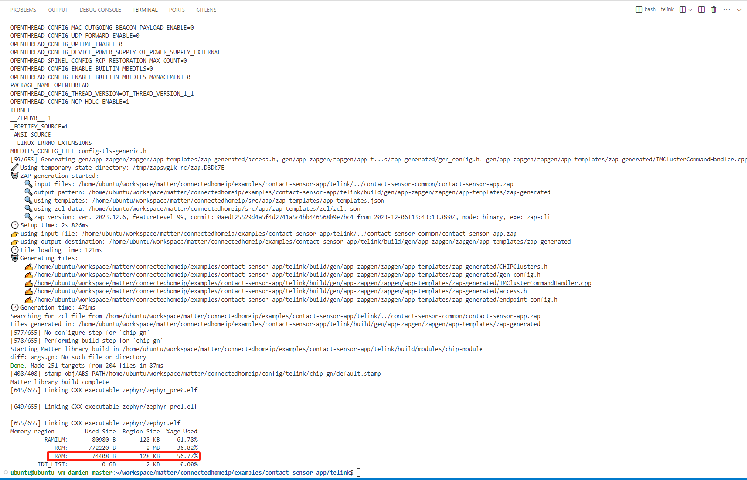

I need help with a battery-operated device (sleepy end device) supporting the Matter-Thread standard.
I have used:
- Connectedhomeip: branch master
- Zephyr: branch develop
- Example: Contact-sensor-app
- Build command: west build -b tlsr9518adk80d_retention
Build error:
"[644/654] Linking CXX executable zephyr/zephyr_pre0.elf
FAILED: zephyr/zephyr_pre0.elf zephyr/zephyr_pre0.map /home/matter/connectedhomeip/examples/contact-sensor-app/telink/build/zephyr/zephyr_pre0.map
: && ccache /home/matter/zephyrproject/zephyr-sdk-0.16.1/riscv64-zephyr-elf/bin/riscv64-zephyr-elf-g++ -gdwarf-4 zephyr/CMakeFiles/zephyr_pre0.dir/misc/empty_file.c.obj -o zephyr/zephyr_pre0.elf zephyr/CMakeFiles/offsets.dir/./arch/riscv/core/offsets/offsets.c.obj -fuse-ld=bfd -Wl,-T zephyr/linker_zephyr_pre0.cmd -Wl,-Map=/home/matter/connectedhomeip/examples/contact-sensor-app/telink/build/zephyr/zephyr_pre0.map -Wl,--whole-archive app/libapp.a zephyr/libzephyr.a zephyr/arch/common/libarch__common.a zephyr/arch/arch/riscv/core/libarch__riscv__core.a zephyr/lib/libc/newlib/liblib__libc__newlib.a zephyr/lib/libc/common/liblib__libc__common.a zephyr/lib/posix/liblib__posix.a zephyr/subsys/random/libsubsys__random.a zephyr/subsys/bluetooth/common/libsubsys__bluetooth__common.a zephyr/subsys/bluetooth/host/libsubsys__bluetooth__host.a zephyr/subsys/net/libsubsys__net.a zephyr/subsys/net/l2/openthread/libsubsys__net__ip__l2__openthread.a zephyr/subsys/net/ip/libsubsys__net__ip.a zephyr/drivers/interrupt_controller/libdrivers__interrupt_controller.a zephyr/drivers/bluetooth/libdrivers__bluetooth.a zephyr/drivers/console/libdrivers__console.a zephyr/drivers/entropy/libdrivers__entropy.a zephyr/drivers/flash/libdrivers__flash.a zephyr/drivers/gpio/libdrivers__gpio.a zephyr/drivers/hwinfo/libdrivers__hwinfo.a zephyr/drivers/ieee802154/libdrivers__ieee802154.a zephyr/drivers/pinctrl/libdrivers__pinctrl.a zephyr/drivers/serial/libdrivers__serial.a zephyr/drivers/timer/libdrivers__timer.a modules/hal_telink/tlsr9/lib..__modules__hal__telink__tlsr9.a modules/hal_telink/tlsr9/crypto/mbedtls/lib..__modules__hal__telink__tlsr9__crypto__mbedtls.a modules/mbedtls/libmodules__mbedtls.a modules/openthread/platform/libopenthread_platform.a -Wl,--no-whole-archive zephyr/kernel/libkernel.a -L"/home/matter/zephyrproject/zephyr-sdk-0.16.1/riscv64-zephyr-elf/bin/../lib/gcc/riscv64-zephyr-elf/12.2.0/rv32imac_zicsr_zifencei/ilp32" -L/home/matter/connectedhomeip/examples/contact-sensor-app/telink/build/zephyr -lgcc -Wl,--start-group modules/chip-module/lib/libCHIP.a modules/chip-module/lib/libMatterDeviceInfoProviderExample.a -Wl,--end-group zephyr/arch/common/libisr_tables.a -fuse-ld=bfd -mabi=ilp32 -march=rv32imac_zicsr_zifencei -Wl,--gc-sections -Wl,--build-id=none -Wl,--sort-common=descending -Wl,--sort-section=alignment -Wl,-u,_OffsetAbsSyms -Wl,-u,_ConfigAbsSyms -nostdlib -static -Wl,-X -Wl,-N -Wl,--orphan-handling=warn -lstdc++ -Wl,-no-pie -lm -Wl,-lc -L"/home/matter/zephyrproject/zephyr-sdk-0.16.1/riscv64-zephyr-elf/riscv64-zephyr-elf"/lib/rv32imac_zicsr_zifencei/ilp32 -Wl,-lgcc -lc -specs=nano.specs -Wl,--wrap,sys_heap_alloc -Wl,--wrap,sys_heap_aligned_alloc -Wl,--wrap,sys_heap_aligned_realloc /home/matter/zephyrproject/modules/hal/telink/zephyr/blobs/liblt_9518_zephyr.a -mtune=rocket modules/openthread/build/src/core/libopenthread-mtd.a modules/openthread/build/third_party/tcplp/libtcplp-mtd.a modules/openthread/build/src/core/libopenthread-mtd.a modules/openthread/build/third_party/tcplp/libtcplp-mtd.a -lc && cd /home/matter/connectedhomeip/examples/contact-sensor-app/telink/build/zephyr && /usr/bin/cmake -E echo
/home/matter/zephyrproject/zephyr-sdk-0.16.1/riscv64-zephyr-elf/bin/../lib/gcc/riscv64-zephyr-elf/12.2.0/../../../../riscv64-zephyr-elf/bin/ld.bfd: zephyr/zephyr_pre0.elf section `bss will not fit in region `RAM
/home/matter/zephyrproject/zephyr-sdk-0.16.1/riscv64-zephyr-elf/bin/../lib/gcc/riscv64-zephyr-elf/12.2.0/../../../../riscv64-zephyr-elf/bin/ld.bfd: section ram_code_ble VMA [0000000000010000,0000000000010013] overlaps section bss VMA [000000000000a700,0000000000017ce7]
/home/matter/zephyrproject/zephyr-sdk-0.16.1/riscv64-zephyr-elf/bin/../lib/gcc/riscv64-zephyr-...
Is there any way to resolve this error? Thank you!!!

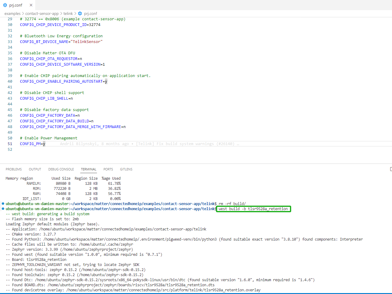

Hi,
  tlsr9518adk80d's retention ram is 64K,Contact-sensor-app need 74K ram ,so tlsr9518adk80d can not run Contact-sensor-app in retention state,you can change the prj.conf change the retention to suspend mode ,also it will increase current.
or you can try tlsr9528a chip,it has 96k rention ram to support Contact-sensor-app
