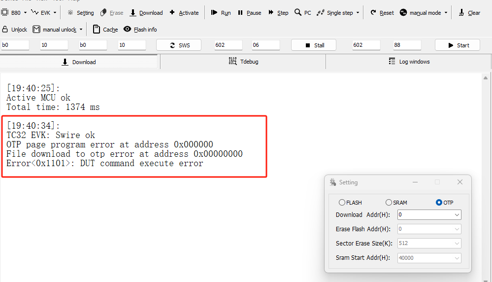

Hi i am trying to burn the otp.bin file but i encounter this error. i am not sure where is my mistake. i hope someone could guide me over this. Thank you.

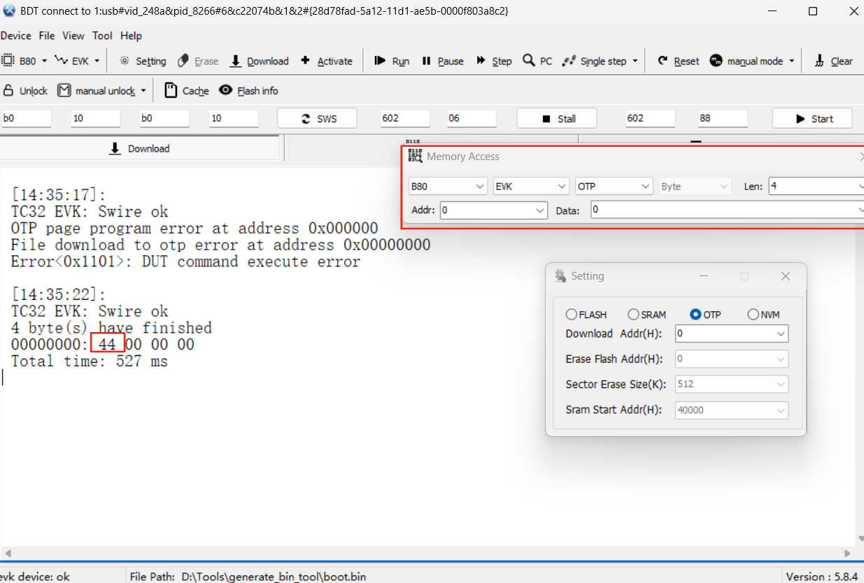

Hi, Please confirm whether the OTP area has been written before, as shown in the figure. In this case, it is no longer possible to download.
85
371
371
发表于 2025-8-20 14:41:41 | 显示全部楼层 来自 上海
TL_WMS 发表于 2025-8-20 14:40
Hi, Please confirm whether the OTP area has been written before, as shown in the figure. In this cas ...
One additional point: the default value for OTP memory is 0xff.

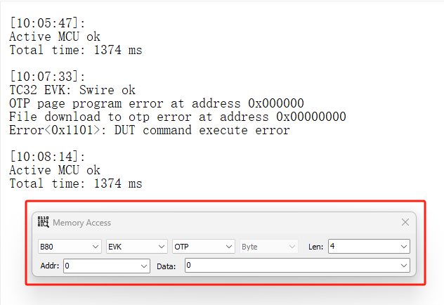

 楼主| 发表于 2025-8-21 10:14:36 | 显示全部楼层 来自 广东
please verify my step : i plug in the device to EVK and activate the MCU. then i click the memory acess. the memory acess shows the same as you mentioned but i dont see the "4 byte(s) have finished .....44" message.
Does this mean i cant download it anymore?

发表于 2025-8-21 10:22:52 | 显示全部楼层 来自 上海
move your mouse cursor to “Addr” box,then click the “tab”key on your keyboard,and you can read the data form the specified memory space
For more information on how to use the BDT tool, please refer to the BDT User Guide under BDT\doc\AN-18101200-E7_Telink Burning and Debugging Tool (BDT) User Guide.pdf.
