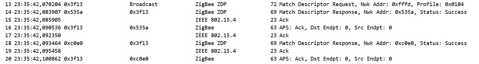

But with the help of a sniffer you can see that both thermostats send a response.

When calling a function zb_zdoMatchDescReq , function zdp_serverCmdHandler is called in zdp.c.
When two thermostats are detected, function zdp_serverCmdHandler is called twice.

seq_num is the same. The addresses are different, they correspond to both thermostats. But the callback function from zb_zdoMatchDescReq is called only once.
